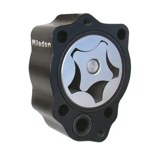

Many mechanical oil pumps look like this.
There is very little mechanical resistance and friction occurring in this design. With very little lubrication this type of oil pump will do just fine in terms of wear.
When you change your oil the fluid in the pump will more than likely not be drained, as a result there will be some lubrication in the pump itself. This low amount of lubrication will be protect the oil pump under the conditions you specified.
I would not be concerned with oil pump damage from the results of an oil change.
