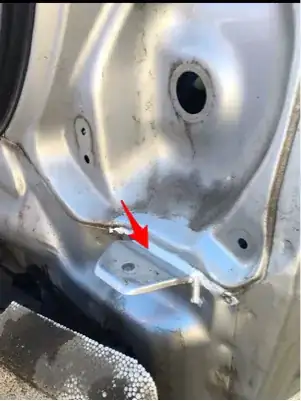

After removing the seat and looking underneath the carpet, there was no evidence of leaking from the heater core. It was rain water, about three gallons of it. Where did this all come from? Nothing from the doors, windows, or underneath the frame of the car.

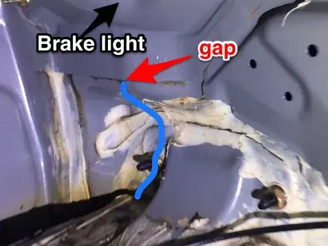

All of this water came from two sheets of metal joining behind the back of passenger brake light. There was a small, small gap between the metal which allowed nearly all the drain water that flowed to the back of the car to leak inside.
brake light leak a closer look
From then on I was convinced water would overflow and pour from the back to the front of the car from this single leak. I then had to remove the bumper frame to apply this water proof coating over the crack:
coating
Nothing has entered the car ever since but in case water did make inside I removed a plug from each side of the trunk where the water would build up:
removed drain plugs
