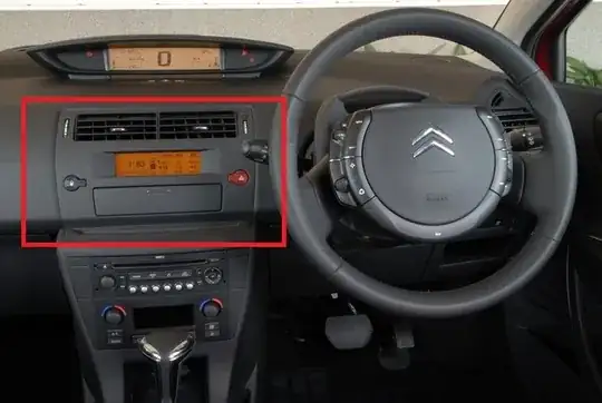

I have a Citroën C4 2005 Petrol. My central dashboard currently looks like this: Citroën C4 2005 Dashboard
I figured I can buy the following panel from eBay and easily fit a Nexus 7 Tablet inside it, potentially even write an app to get data from OBD2, and even fit the screen inside the glove compartment.

My idea is to have the tablet as radio, sat-nav, media player, diagnostics etc.
I'm just not entire sure if the panel from eBay would fit my car as it is for a slightly different model C4 even though they look quite alike.

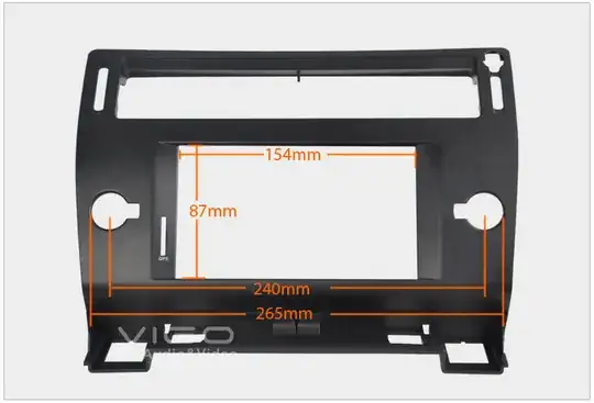

There is no way for me to tell if the attachment system from the back is compatible, but the eBay listing has a very useful image for you shown below.
What you need to do is verify with a ruler or measuring tape that the dimensions between the hazard lights button and corresponding button on the left has a center-to-center length of 240 mm and end-to-end length of 265 mm.
