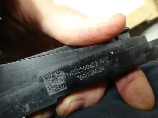

It looks like the BMW part number for the thermostat is 11537600584.
A quick search on eBay seems to confirm that the thermostat setpoint is 105 °C:
Thermostat
As @Paulster2 said, I wouldn't be concerned about the temperature; the car isn't overheating.
