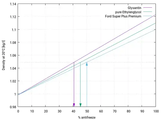

From the datasheet of your Ford antifreeze, the density is 1.10kg/l, while pure ethylen glycol has 1.10kg/l. Glysantin is another brand for antifreeze and states 1.122-1.125kg/l for its G48 (sorry, german)
This differences aren't big, are they?
Water has a density of 0.998203 kg/l (at 20°C, as all values above), so one could approximate the density of any mixture by a linear function:
From this, a 50% mixture from Ford Super Plus Premium has a density of 1.047kg/l. The same density has a 40.7% Glysantin G48 and a 45.4% Ethylan Glycol mixture.
According to Glysantin's website, a 1:1.5 mixture (i.e. 40% antifreeze) protects down to -27°C instead of -37°C, which is a vast difference!

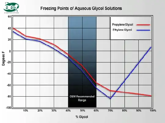

For pure ethylen glycol, I found this chart (in °F):
http://www.eetcorp.com
which also shows a serve reduction for lower concentrations of antifreeze.
So, slight differences in density of the andifreeze will result in very different temperatures displayed on a hydrometer.
This still does not explain your reading of -23°C, but the linear function is just an approximation, temperature changes density, too, and who knows what other effects there are.
