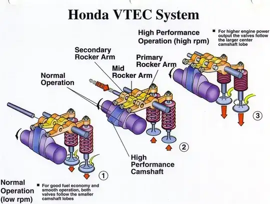

I would be primarily concerned with the i-VTEC cam related mechanisms. I do not see that this engine is an interference engine.
If it were an interference engine and you floated your valves, you would have more than likely had valve to piston contact and that would have immediate effect on your motor as well as your driving experience, you would have been on the side of the road with a destroyed engine.
VTEC Diagram
The red arrow from left to right illistrates the pin insertion to engage the higher cam lobe profile.  It engages the mid rocker arm to do so.
Description: The red arrow from left to right illistrates the pin insertion to engage the higher cam lobe profile. It engages the mid rocker arm to do so
Concern
My primary concern with what you described would be related to the engagement pin for the higher cam profile and the possibility of that shearing. I do not know or have any prediction on how accurate my concern would be, this is simply based upon my previous experience of seeing engine failure, not my experience with this particular situation or valve train type.
The Concern - if the RPM's increased so rapidly that the engagement pin for the higher RPM did not have the time to insert itself into the secondary rocker and was sheared or the pin became rounded in the process of an attempted insertion. You may not experience issues now but if it became rounded the issue could be aggravated over time and become worse. If the pin was sheared then you would have some immediate effects such as reduced power at higher RPM's because the higher cam lobe is not getting engaged.
As well, if it were sheared you would probably hear some noise coming from the top end as your would have some failed components floating about...but any lack of noise is not a guarantee that a failed event did or did not occur.
