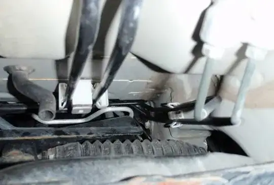

Your AC drain may be stopped up. Your AC evaporator condenses water when the warm moist air passes over it, this happens in the normal operation of the AC. There is a drain that is suppose to drain the water outside the car, when it gets stopped up water collects in the evaporator case under the dash, it will eventually drain somewhere, most likely on your carpet inside the car, in the mean time you will be able to hear it sloshing around.
Look under you hood, or from the underside of the car for a rubber tube sticking out of the firewall, you can unplug it with a coat hanger, or piece of wire.
The picture below may be what you have, if not it will at least give you an idea of what you are looking for.
Picture Source
