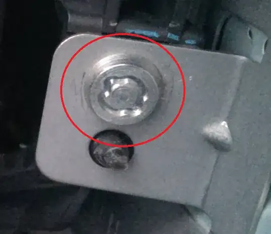

I just tried to replace my 2010 Legacy's stereo today and found out that there is some weird bolts (refer to attached image) holding the stereo brackets. I can not get that bolt out. Its got a head that I have never seen before. Can anybody tell me a tool to remove this?

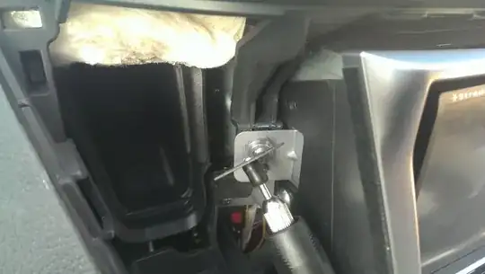

UPDATE: Could not find any matching tool to take it out properly. Had to cut the bolt head with a rotary tool.

If you are talking about this:
It appears to be a captured bolt ... you won't get the bolt itself out by itself. Look on the back side for a nut to take off, then the whole thing should come out. The hole just below it and the thing protruding through it appear to be an alignment nib.

Got the damn thing out finally. Had to use a rotary tool to cut the head.
