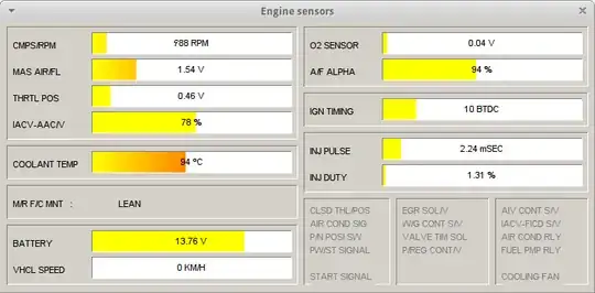

So I got a scan tool and some new info:
This capture is at about 788 rpm I think with no loads. The first thing is that it reads lean at idle most of the time, but at 2k rpm it oscillates between rich and lean together with the O2 signal.

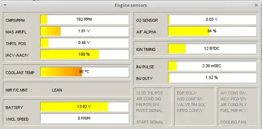

Something that stood out to me was the IAC percentage open which seems really high at 78%. If I turn on the headlights, it maxes out at 100% open:
If I turn the lights back off, it drops back immediately to 88%, then slowly returns to 78%.
I turned the lights back on, and once the temp hits 97*C and the radiator fan comes on the idle will drop to the 600's, and start bouncing. If I start turning the wheel back and forth to activate the power steering pump I can force the engine to stall. Which seems odd to me since there is a separate PS idle up switch, same as for the air conditioner. Yet when I turn on the AC, even with the lights and radiator fan already on, the idle up works and it goes up to 850rpm and everything stabilizes:
You can also notice that the injector pulse jumps 50% and the duty cycle almost doubles, even though there's been only a small increase in RPM.
Sooooooo, here's what I'm thinking. This car actually has what seems to be two IAC type devices sitting one on top of the other, one called the Auxiliary air control and the other called the Fast idle control device. I figure the maxed out one is the primary IAC, and maybe it's partially clogged and that's why the ECU is opening it so much. Maybe the radiator fan and power steering idle-up switch are connected to this one, which is already maxed out and that's why problems start when they come on, while the AC idle up is maybe connected to the second one.
I'm wondering if this could account for what seems to be a lean condition most of the time, or if that could be a separate problem of it's own? The thing is that this problem started gradually and it would seem highly coincidental to me to develop both a clogged IAC and an intake leak at the same time.

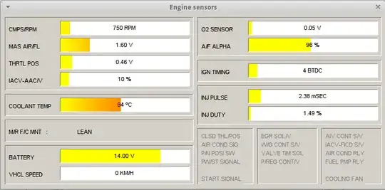

I opened the idle air screw 3/4 of a turn and now IAC is showing 10% open at idle with no loads, idle stable at 750 rpm, and I can put on the lights, defroster, fan and radiator fan, and swing steering wheel back and forth as much as I like without any problem. I can't force a stall like I could before.
This is idle with no loads:

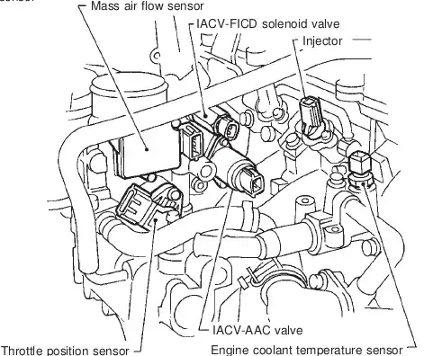

So I just found in a GA16DE manual pg 59 that IACV-AAC/V at idle should be between 0%-40%. ( There's a list of engine control reference values starting on page 58. )
Here's a diagram:

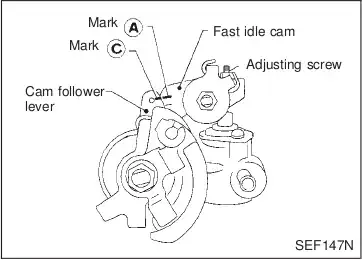

On some of these engine's there is also a Fast Idle Cam ( pg 55 ) which I guess can open the throttle plate, I'll have to go check mine later and see if it has one:
