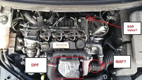

Here is a picture of my engine with the cover off. I've circled what I believe is the EGR valve, you can just see its barcode sticker in the picture (zoomed in):
Ford Focus 2008 TDCi 1.6
Questions:
  1. Is this the EGR valve? If not, where is it?
  2. The advice seems to unanimously be to blank it. Is this legal? I couldn't find any UK/EU law on this.
  3. Is this the MAF? If not, where is it?
  4. Is it safe to disconnect the MAF temporarily?
  5. Any other suggestions to try before contacting Uncle Ford?

I think @Paulster2 might be right about the MAF. I've taken some photos of what I think is the inlet for it, but it's so dark I'm not sure if you can see:
MAF 1 | MAF 2
Actually, I've just found a YouTube video detailing cleaning the MAF on an '08 Focus and it seems I wasn't far off!

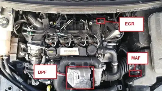

So after several hours under the bonnet this weekend I can answer the questions above in the hope that this is useful to anyone else suffering from DPF issues with a Ford.
  1. Yes, that is the EGR valve. The piece you can see with the barcode is the stepper motor, and the valve is directly underneath.
  2. I can't see anything to suggest this is illegal in the UK. The consensus seems to be that on a diesel engine nobody will notice/care.
  3. The MAF is actually under the label in the original diagram. See the updated one below.
  4. Yes it is safe to disconnect it. The ECU will complain, but it doesn't cause any harm to the engine.
Here's the updated diagram labeling the parts:

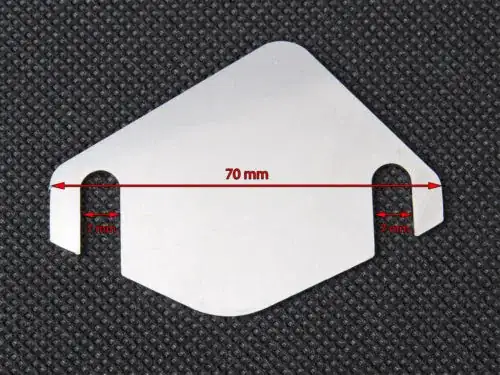

Unfortunately this has not solved the issue for me and the error is still occurring. I have now ordered a blanking plate like the one shown below and will fit this next to see if the error is resolved.
Hopefully this will do it otherwise I guess I'm off to the garage!
