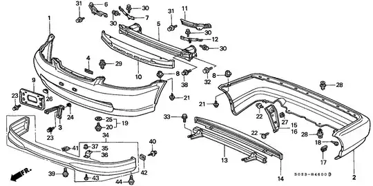

The front licence plate bracket on a Civic consists of 3 parts. The first is the part your dealing with. Inside the bumper there should be plates with nuts welded to it. Number 4 in the picture, 2 required. The only way to get at it is to remove the bumper fascia (plastic cover). In a civic this is pretty easy. There are only a hand full of bolts and push pins holding it in place.
The second is a bracket that holds the bottom of the license plate. Number 3 in the picture.
The third is a license plate frame. Number 9 in the picture. enter image description here
