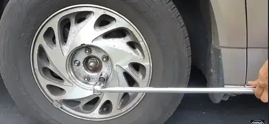

I broke two of my car's lug nut studs, and I had to take the car to mechanic for repair. The mechanic explained that sometimes lug nuts are highly over-torqued because all shops use impact gun to tighten them, but does not cause any problems as long as they are opened using an impact wrench.
Also, my mechanic explained that using a breaker bar (like below) in over-torqued situations can damage the studs.
breaker bar
Is to correct to say that avoiding breaker bars and using an impact wrench instead prevents damage to nuts or bolts?
Is it correct to say that over-torquing lug nuts with an impact gun is fine as long as we open them with impact gun rather than a breaker bar?

I can see where your mechanic is coming from. The reason being that, although like Steve Cross notes, the impact wrench applies a lot of force suddenly, it applies the force in an evenly rotational direction. ANY wiggle in the socket (Which there will always be or you wouldn't be able to get it on the nut) and the breaker bar will be putting lateral force along with the rotational force. That will increase chances of breaking the stud. This is why steveverrill recommends to hold the nut end when using a breaker bar, although I'm not sure if that would do much good with so much leverage.
I don't have an impact wrench, and having broken a few studs using a bar or the tire tool that comes with the car, now I always use a four-way to remove lug nuts. It's not as good as an impact wrench but the upward force on one side helps balance the downward force on the other. I've never broken a stud with a four-way. (I have, though, broken a four-way, be careful.)

Using excessive force on a short bar will damage your wheel nuts. Force will not undo them. Torque does. A nice long bar like in your photo will apply more torque with less force. I would put my other hand on the nut though, to balance the force applied to the bar, and ensure as much as possible that only torque is applied to the wheel nut.
