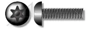

I believe with Kawasaki's you be required to have a pin in torx (also referred to as tamperless torx) driver in order to remove the ignition switch.
