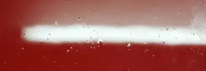

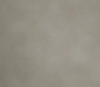

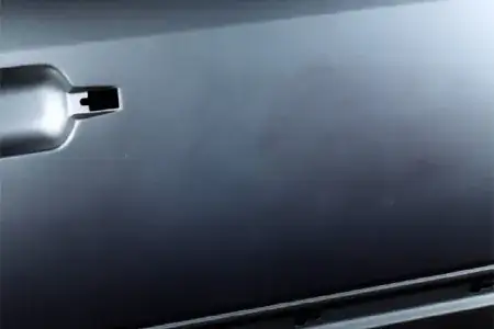

Air Trapping (Craters) [Rapidly during/after painting]
air trapping

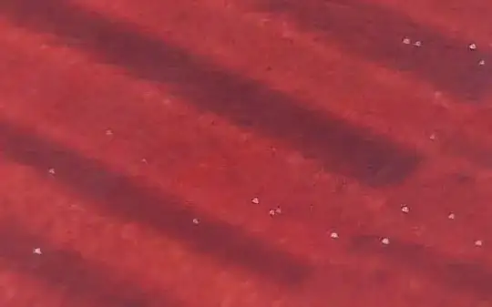

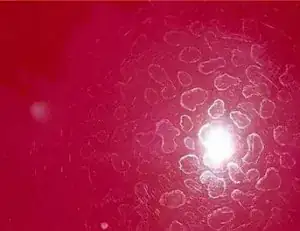

Bleeding (Discoloration) [Rapidly after painting]
bleeding

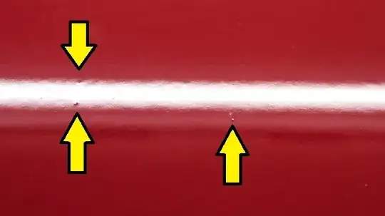

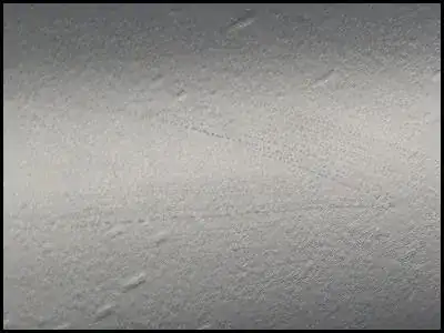

Blistering (Pimples, bubbles, bumps) [Often weeks/months after application]
blistering

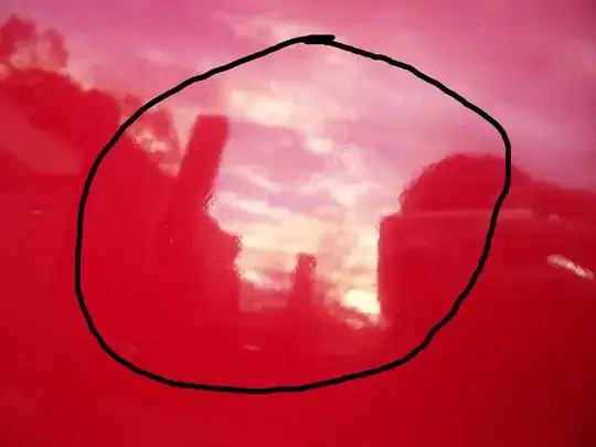

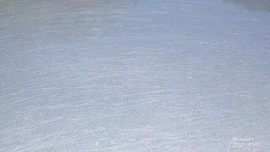

Blushing (Milkiness) [Rapidly during/after painting]
blushing

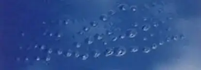

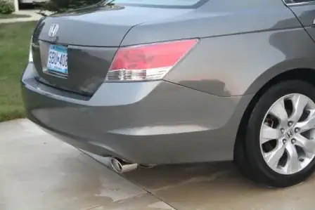

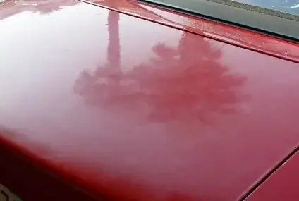

Chalking (Fading, oxidation, weathering) [Rapidly after painting/Naturally over time]
chalking

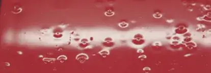

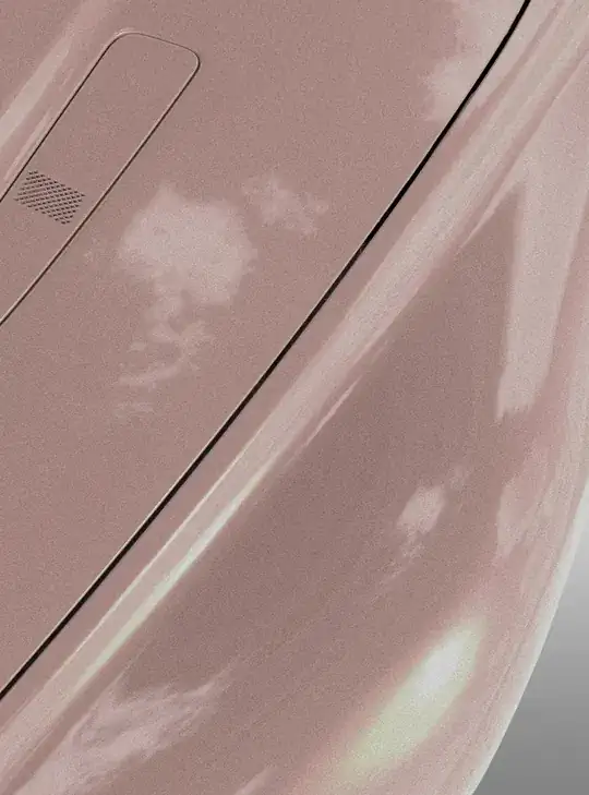

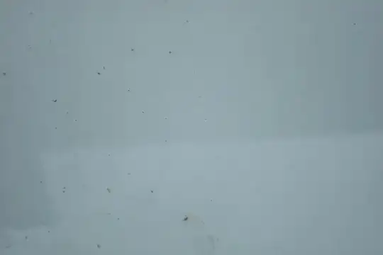

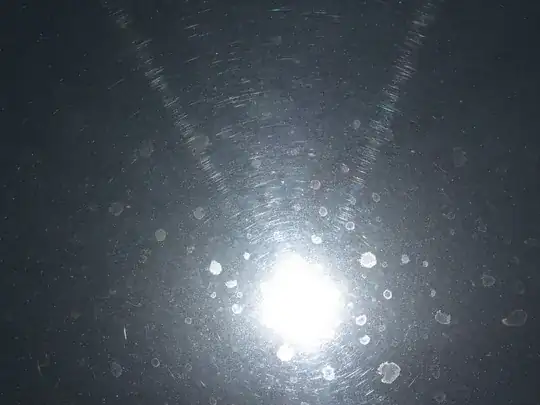

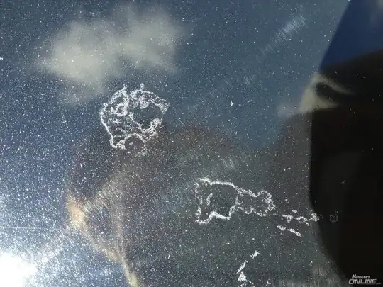

Chemical staining/etching (Spotting, acid rain, discoloration) [Happens due to chemicals on paint]
acid rain
bird poop etching

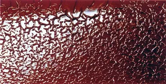

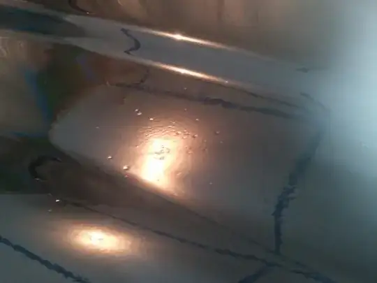

Cracking (Checking, Crazing, Spitting, Alligatoring, Crowsfeet) [can happen over long periods of time]
cracking

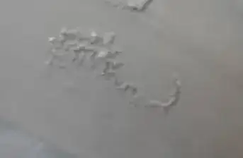

Edge Mapping (Edge ringing, featheredge lifting) [Rapidly after painting]
edge mapping

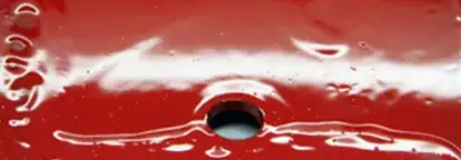

Fisheye (Silicone contamination, cratering) [Rapidly after painting, not later]
fisheye

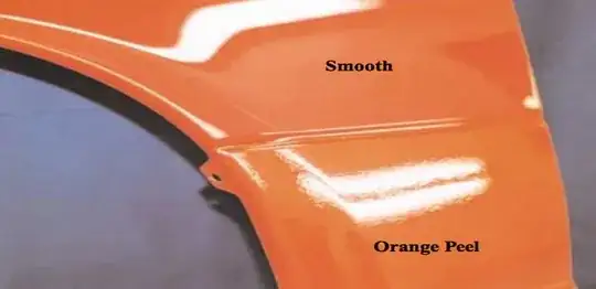

Orange Peel (Poor flow, texture) [Rapidly after painting]
orange peel

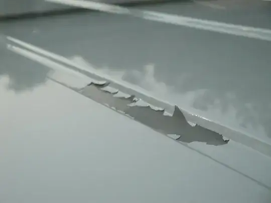

Peeling (Flaking, delamination, loss of adhesion) [Many causes, many times]
peeling

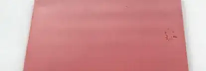

Pinholing (popping, bubbles, air pockets) [usually above body filler, rapidly during sanding]
pinholing

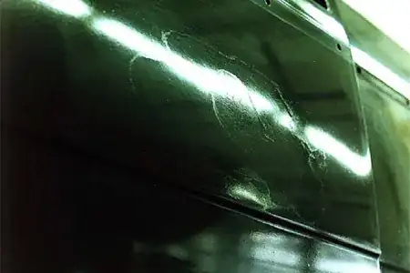

Sanding Marks (Streaked finish, sand scratches) [After sanding]
sanding marks
