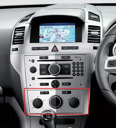

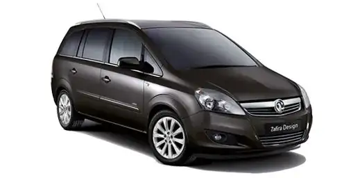

If you car meets all of these criteria, then you are definitely affected.
  • Zafira B (all model variants) enter image description here
    If your car design is not like this, you are not affected.
  • From years 2005 - 2014
  • Right hand drive
  • Manual Air Conditioning or without Air conditioning. (NOT climate control)

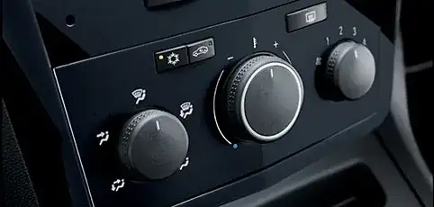

  1. Get into your car, and look at the heater controls:
If your controls look like this (ignore the colour):
Then you are affected. You should not have an AUTO button.

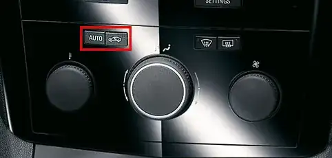

If your controls look like this (note the AUTO button):
Then you are NOT affected. You don't need to do anything
