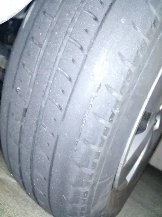

Tire with bead damage
This is my front passenger tire. As you can see, there is a large crack where you can see wire underneath. I ordered new tires that are supposed to arrive on Friday, however, I still need to get to & from work every day this week (approximately 10 miles of highway x2 per day). Is this tire safe to drive to work, or should I wait to drive it directly to the mechanic to change out the tires when they arrive?

The only advice anyone could possibly give about this tire is that it should not be taken on the road. Out of respect for other peoples lives, the car should not be driven with even one tire like that on it.

In the UK, it would be illegal to drive on this tyre. Therefore, if you were stopped by the police, they would have the right to stop you driving further, order a tow-truck to collect your car and remove it. They could then fine you and charge you for the costs of towing and returning your car.
I don't know about other countries.
The tire in the photograph is not safe to drive on, but that does not mean that you cannot drive the vehicle to work. If the vehicle has a full-size spare tire, then replace the worn tire with the spare, and use the worn tire as a spare.
If in fact you do need to use the worn tire as a spare, then keep the speed below 50 KPH / 30 MPH. That speed is often considered the speed at which the rotating stresses on the tire approach or exceed the weight stresses on the tire.
Note also that your worn tire is not worn evenly. That likely means that your front-end needs to be properly aligned, lest you wear out the new tires in short order as well.
