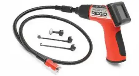

On edit: After watching @Zaid video link, It occurred to me that you could drive the tank close to empty, and then use one of those inexpensive flexible inspection cameras to inspect the tank without removing it. (Easy since a diesel has no filler neck restriction.) I got mine at Home Depot, it's a "Rigid SeeSnake" brand, but there are many other inexpensive Chinese units that are nearly identical (and it's a fun toy, errrrrr I mean a valuable tool to have anyway):
