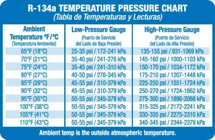

Before recharging, I googled 'r134a pressure chart', and found the following: r134a pressure chart
At the time, it was 82F in my garage, so I was expecting to end up in the middle of the range (both low- and high-pressure) for the 80F row.... 45psi for low, and about 190psi for the high side. (When referring to this chart, I assumed that the target low readings were for when the clutch was disengaged, and the target high readings were for when the clutch was active.) However, after my recharge the highest low reading I see (right before clutch engages) is 40psi, and the highest reading I ever see for the high side is 150 (right before the clutch disengages.)

That chart is not universal. You should be fine.
Every model will have its own characteristic low-side and high-side pressures.
This is why some manufacturers recommend charging refrigerant by mass rather than by high-side, low-side and ambient temperature values.
As long as you have charged the system with the correct amount of refrigerant (which you have according to the tolerance defined in your manual), you should be fine.
Another sanity check is that the low-pressure switch activates at 32 psi, which is lower than the 40 psi you are seeing on the low-side.
I'm not sure if your Lancer is equipped with a high-side pressure switch but the same principle applies.
Enjoy your ice-cold AC!

You should be able to check the correct operation even though you do not have the vehicle specific values. This can be accomplished by checking super-heat and sub-cooling.
While the chart you have put is not universal, the temperatures that the refrigerant turns into liquid and vaporize only depend on the pressure and it has a chart also. Same as water boiling at sea level at 100C(212F) but at lower temp at high altitudes because pressure is less, same rule applies to refrigerant.
So, using laws of physics you can tell a lot about the operation of the system. For example you can tell if the refrigerant is in liquid form when leaving evaporator and entering the compressor (which would be bad for the compressor).
