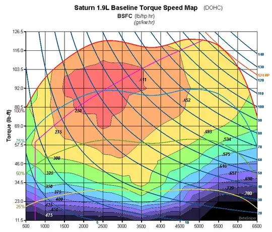

The specific answer to your question lies in the BSFC (Brake Specific Fuel Consumption) map for your engine, combined with the desired output.
The BSFC map shows how efficiently the engine converts chemical energy to mechanical work at any given condition.
Here is an example:
BSFC Map
