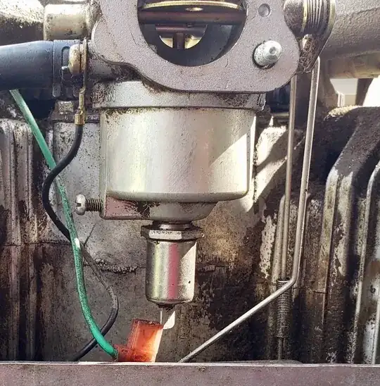

My problem, LX277 17 hp Kawasaki, engine starts and runs good cold. After 5 to 10 minutes, the engine would die. Just like you turned the key off and would not restart until the engine cooled down.
  1. Removed air cleaner and sprayed starting fluid in carburetor. The engine started and died.
  2. 12 volts was found at the fuel shut off valve.
  3. Removed the valve and applied 12v. Plugger would hardly work. Purchased a new shut off valve and tested it. No problem.enter image description here
