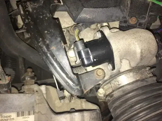

1995 Chevy S-10 Blazer - 4.3 L Vortec V6 (vin W with PCM) - 230,000 miles original owner.
I changed my IAC Valve today, and coincidentally, my HVAC started blowing out of the defroster and floor no matter where I put the HVAC selector or fan switches. This happens in all modes, AC, Heat, Vent, etc.
I don't see how this is related to my IAC Valve, but I put the old one back and the HVAC problem continues to be present.
I've had a similar problem in the past where it was intermittent and replacing the HVAC control switch fixed it. This time, the HVAC control switch was just replaced a couple months ago with a genuine AC/Delco part and it was working perfectly until today.
Now, immediately after changing the IAC Valve, I can only get air to blow out the defroster and floor simultaneously.
I did a lot of work on the car over the summer so I remember the recent vacuum readings. I checked the engine vacuum today and it's measuring the same as before.
I also checked vacuum lines and intake manifold for leaks by spraying carb cleaner at these areas. There are no leaks and the engine is running fine... actually running better after changing the IAC Valve.
What could be causing the HVAC to always blow out of the defroster and floor? I've ruled out the IAC Valve replacement as coincidence since swapping with the old IAC made no difference.
EDIT:
Changing the IAC Valve on this vehicle involves two small screws and one electrical connector. NO vacuum lines are involved with this or located nearby.
