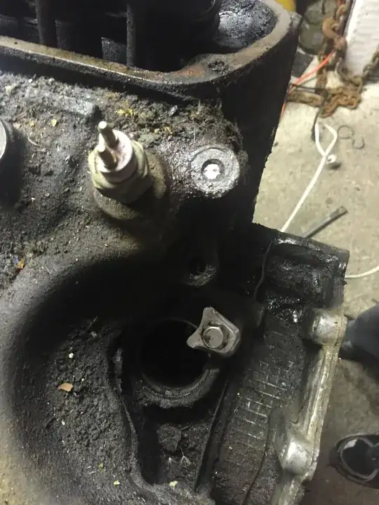

While trying to remove the intake manifold from an old Ford 302 one of the bolt snapped off. As you can see below it is just about flush with the manifold (just below.
What's the best way to get this out? Do I have any choice but to drill it? Broken bolt

I would remove the remaining bolts if possible, and attempt to lift the manifold off enough to rotate and clear. If it works, use the penetrating oil and heat as previously suggested then vice grips on the bolt shaft. Caution on heat, turning while very hot will just twist off the bolt again.

I think that the hole in the intake is not threaded and the bolt goes through the manifold and threads in to the head. If that is the case you should be able to pull the manifold off and then address the stuck bolt separately. A good soak with PB Blaster always helps and the previously mentioned trick where you weld a nut on to the top of the broken bolt works surprisingly well.

Peter & Fred are the only ones who are giving good advice here (surprisingly not being upvoted?). I'm pretty sure that on a 302, if you remove the rest of the manifold bolts, the manifold will lift straight off, and there will be 3/4" of bolt sticking out. Clamp on to this with a large set of vice-grips, and turn the bolt out.
If the vice-grips slip, clamp them on a little tighter, and hit their handle with a hammer such that they turn counterclockwise. The impact action may work better than just turning.
I'm pretty sure that this will work, but if not then welding a nut to the shaft of the bolt will be a lot easier with the manifold removed.
The manifold itself is probably stuck to the gaskets, so you might need to hit it with a hammer to break it free prior to lifting it off. Sometimes there is a protrusion in the manifold where you can get a prybar in between it and the block to pry up, without prying in the actual gasket area; don't be tempted to insert anything in between the manifold and the block; (ie. hammer and chisel) if you mar the mating surfaces the new gasket will not seal, and you will have a vacuum leak.
