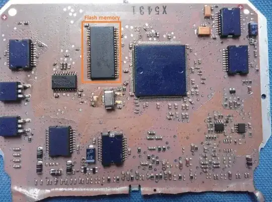

Since I have the Old ECU would it be enough to just replace the old chips into the new ECU? Are there other things I should be considering during the replacement?
Inside the broken ECU :

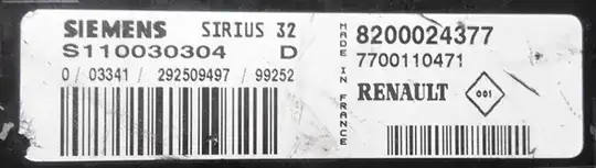

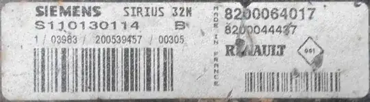

I have replaced he old ECU ( SIRIUS 32N ) with another one ( SIRIUS 32 ) which is used before, the car has not started the first two tries but have started normally the third time, the immobilizer light have not been blinking which means there is no immobilizer problem and this means either the ECU is already decoded ( it is supposed to not be decoded according to the seller ) or the Immobilizer is a separate device that sends a confirmation to the ECU to start hence changing only the ECU won't create a problem.
the old ECU :
New ECU :
