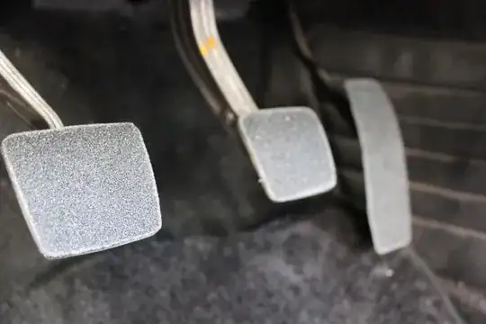

Use Coarse Grip Tape
Although your pedals may be beginning to wear out, I have found that even new pedals can sometimes be slippery depending on what type of shoe.
If you apply non-slip tape to your pedals, it will make them much less slippery. This tape is widely available, commonly used in RVs, and is basically adhesive 80-grit sandpaper.

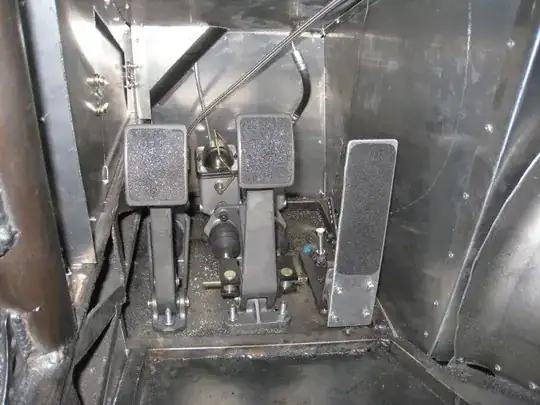

Get some grip tape and put it on your pedals
Grip tape will allow you to use your pedals even if your shoes and wear we and give the traction you need to prevent your feet from slipping off of them when you use them.
Grip tape is used on the decks of watercraft and boats as well as the tops of skateboards to accomplish the same goals you have, more friction.
You can use a pair of scissors and apply a few strips of the tape to each pedal.
Grip tape is often used on pedals in racing vehicles to accomplish the same task.
You will find this to be VERY effective. I do this on all my vehicles and have been very satisfied with the results.
