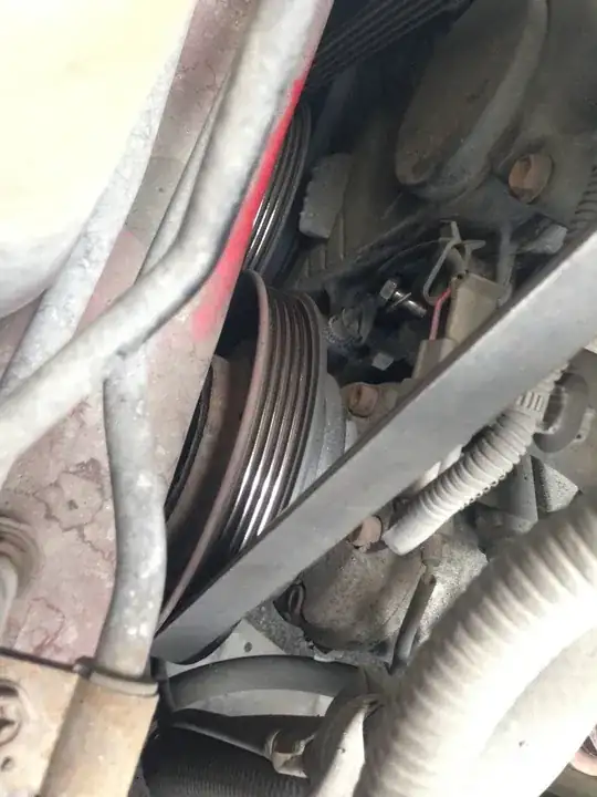

  6. Loud rattling noise from the generator in the range of 3,400-4,000 RPM
  7. There is a bolt loose on the engine. We're unsure what it does. See picture:
    Missing bolt

  • Can't comment on 6 & 7
    They may be related to one another. Difficult to say from just that picture.
