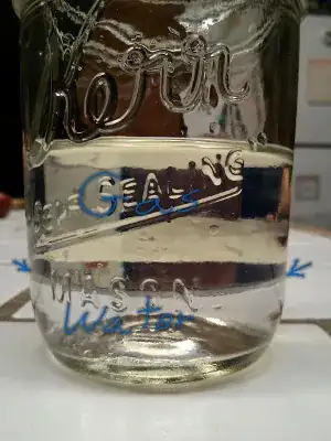

Water in fuel is easy to figure out. Put a sample (say 5 to 10 ounces) of the fuel into a clear glass container. Let it sit. If it separates into two layers, you have water in the fuel.
demonstration of water and gasoline separating
Shown: an obviously contrived example of gasoline (10% ethanol) with approximately 2 ounces of water added - water has visibly sunk to the bottom of the jar.
