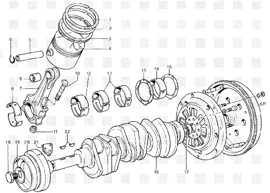

To get to basics, the rod (or connecting rod) is the portion of the engine which connects the piston to the crankshaft. Where the rod connects to the crankshaft there is a bearing which separates the rod itself from the crank journal. The bearing is made from a softer material than the rod or the crankshaft.
You can see most all of the internal parts of an engine in this exploded view below.
The connecting rod is #7, the crank shaft is #16, piston #4, and bearing can be found marked as #8.
When an engine is built, there are certain gap tolerances (specific distance measured in .001") which are built into it, the rod bearing to crankshaft journal being no different. In this case, the tolerance is there to allow a specific amount of oil through from a hole in the crankshaft journal and remain on the bearing surface. Oil films on the bearing and keeps the two parts from touching during normal engine operation. If the clearance gets too big from either wear or deformation, the oil will no longer film correctly and you will get the rod knock. The noise itself occurs due to metal on metal contact between the bearing and the crankshaft journal during the power stroke of the engine cycle. If the situation is really bad it can even be caused by the rod itself contacting the crankshaft journal (where the bearing has become out of place). The most common cause of rod knock is due to a spun bearing (bearing itself actually spins in the end of the rod so it becomes out of position). This usually happens due to rod cap stretch during abusive driving situations. It can also happen due to a lack of lubrication, either because of a lack of oil or because oil is flowing incorrectly. It can also be caused by a combination of any (or all) of the three.
