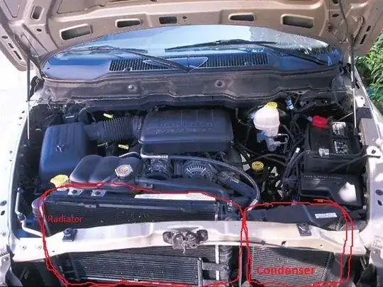

I have a 2002 Dodge Ram 1500 with a 4.7 liter the condenser fan isnt coming on does anybody know why it would not come on

In a regular car the radiator and condenser are usually directly on top of each other and have only a single fan for both. In 2002 Dodge Ram 1500 4.7L the hood areas is so wide that the radiator and condenser are next to each other and each has their own fan. See picture. enter image description here The radiator should have a mechanical fan that sits in the middle and the condenser should have an electric fan that cools just the condenser.
