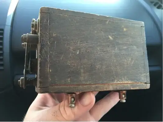

My Father-in-Law gave this Ford branded ignition coil to me today.
I'm curious to know what vehicle it went to, and how it was hooked up originally. Can I easily determine whether it works or not without connecting it to the vehicle it was designed for?
wooden box with exposed terminals and a relay on one end

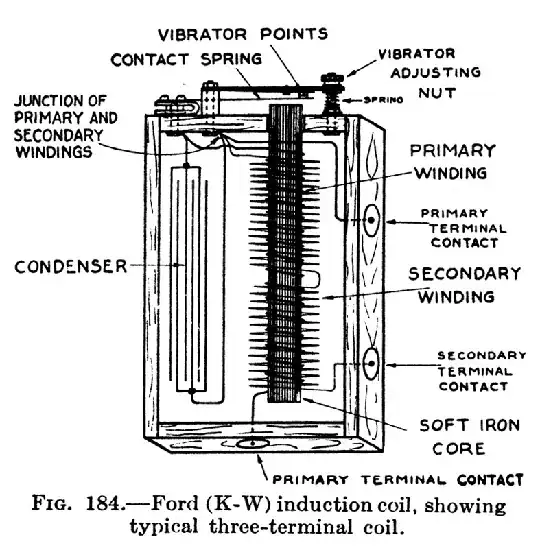

Since you said it has Ford on the case, this would most likely be a coil for a Model T. I don't exactly know how you'd test it, but I found this document from a Model T Ford website. I think it would be very hard to try and test, as there are adjustments of what I'm calling the top (to the left in your picture). There are adjustments needed for the vibrator which is next to the spring and under the "V" bar (again on the top). Here is a detailed image of what the part names are located there:

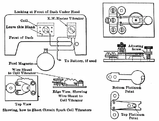

Here is the basic layout for the entire coil:
Both of the above images were pulled from the website linked above. You may be able to find something which will help you with your endeavor there, as the document seems fairly comprehensive.
