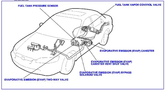

I happen to have the same experience as you when sitting in my 1998 Honda Accord after it has been shut off. The humming sound lasts 5-6 seconds, and it can be 5 to 10 minutes apart. The noise is definitely coming from underneath the car ahead of the rear wheels, not from the engine. I have also noticed that I have never heard the noise in the winter, only in the 70-110F range.
From people I've talked to, it could be a part of the EVAP system, (located at the rear of the car on '98 Accords, possibly yours too) venting excess pressure from the gas tank.
The fact that you heard it coming on more frequently in 110F weather could make sense because air expands at high temperatures; therefore, the pump goes off more often.
Here is a picture of the EVAP system for the 6th generation Honda Accord. I also went and looked at pictures of the 7th generation Accord, and the 2nd generation Acura TL. All three pictures showed the same location of the "EVAP canister vent shut valve", ahead of the gas tank and under the floor of the car.
EVAP system
Picture: JustAnswer.Honda
