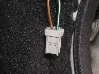

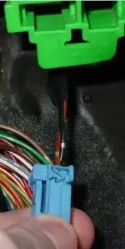

Here's some examples of what the connector looks like (supposedly).

It's just in front of the front passenger side door, under the dashboard. It might be stuck down behind the carpet a ways.
If you remove the passenger side foot kick panel covering the ECU you will see it there. On the 97 it is the blue 2 pin plug.
