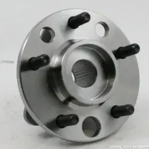

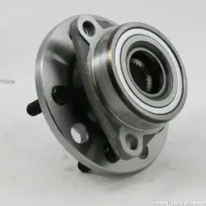

IF you cannot get the studs out, you'll need to take the hub assembly off from the steering knuckle. To do that, there is the bit nut which is used to keep the drive axle in place on the front (left image). Then there are three bolts which hold it onto the steering knuckle (right image). Be careful when pulling the hub out as you can damage the wheel bearing and would need to replace the hub.
