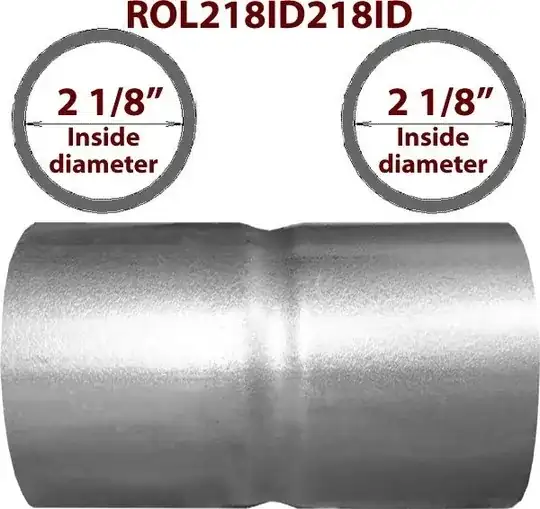

If you don't want to weld, you can use a joint like this:
NOTE: The above image is for demonstration purposes only. I couldn't readily find one which was 2" on each side.
The only difference is, the inside diameter on both ends would be 2". Your outside diameter 2" pipes would fit inside. Use two muffler clamps to attach. You'll need to match the outside diameter of the butt joint, but they would probably be 2 1/8" clamps.
