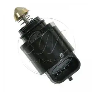

The culprit is probably a sticky or malfunctioning Idle Air Control (IAC) valve. Lucky for you it is located right on top and connected to the throttle body. You can try taking it off and cleaning it, making sure not to play with the pintle (plunger) itself, as the gears inside which actuate it can easily be broken/stripped. Use some carburetor cleaner both on it and in the throttle body area where it comes out of. You may find that the passages are partially blocked.
If cleaning it doesn't work, you'll probably need to replace it. Luckily, they aren't really that expensive.
Here is a picture of what it looks like:
This video points out exactly where it's at. The guy is talking about a high idle problem, but if the IAC isn't functioning correctly (ie: slow to react) it can cause the issue you are talking about.
