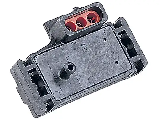

MAP = Manifold absolute pressure and is a sensor to measure vacuum, the computer calculates the engine air flow based on the vacuum, throttle position, and intake air temperature. The computer also measures the barometric pressure using the MAP sensor before the engine cranks, this lets the computer compensate for altitude, or how dense the air is.
Typical GM MAP Sensor

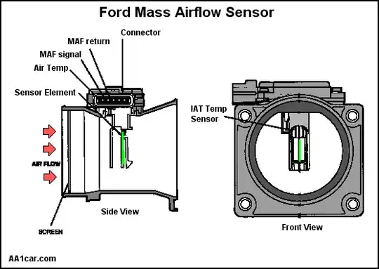

MAF = Mass Air Flow and is a sensor that measures the actual air flow going into the engine.

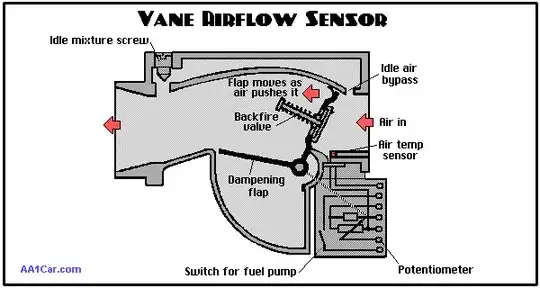

The one above heats a wire and then measures how much the airflow cools it off so it can determine the air flow. While the one below just measures how much the airflow opens the door.

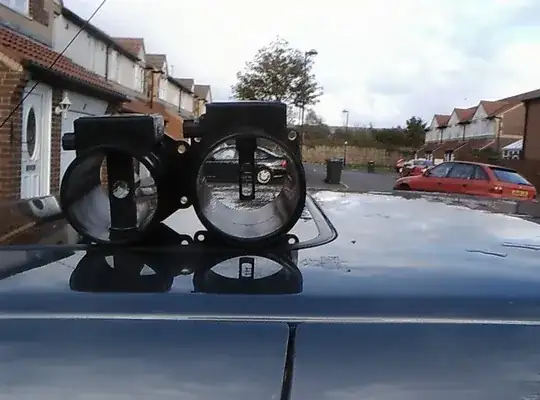

  • the sensor sits in the intake and thus restricts airflow. Airflow restrictions translate to performance restriction, particularly with vane style air flow meters. A simple example of this is the comparison between a Subaru STI MAF sensor and a standard WRX MAF sensor. Third party ECUs (eg. Microsquirt) recommend using manifold pressure although they can accomodate MAFs if they are to be used.
