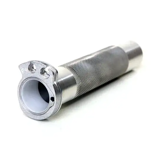

The on/off throttle transitions can be resolved by a mixture of remapping ECUs (in the case of a fuel injected bike) or re-jetting the carburetors as well as fitting a "Throttle Tamer Tube" to your accelerator handle. Basically its a slightly different shaped cam on the Throttle handle that slows down/speeds up the transition so between on and off throttle so that the bike behaves more as you expect/want it to.
An example of a throttle tamer can be seen here
Throttle Tamer tube
If you look at the left side you will see the tube is shaved slightly to slow the response down a bit (i.e. slow the butterfly in the throttle body opening so fast), others can be found that speed up the throttle opening.
