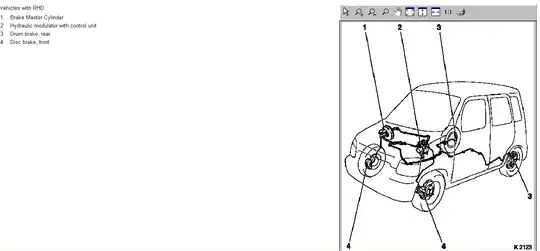

Here is a diagram of the system. It doesn't look complicated:
ABS System Diagram

Typically if the car you drive was available with ABS and you are able to locate a car otherwise identical to yours at a scrap yard then the cost will be considerably less than ordering the parts new. However, only if you have the tools available, somewhere to do the work and the skills needed would you be able to make the conversion economically viable. You would then have the issue of trying to find an insurer who would accept a car which had a non-standard braking system (even if it was taken from another car the same, you would still have to declare it as a modification). You may find they would want an engineers report to certify the installation.
The free alternative is to learn an advanced driving technique called cadence braking. This allows you to manually do the same job with your right foot as an ABS module does. Cadence Braking
Steve Matthews
  • 23,464
  • 41
  • 92
I was quoted the equivalent of about 1000 GBP to retrofit it to my old Corsa B. I assume that includes labour AND parts.
All things considered, it would probably be cheaper to fit larger (ergo wider) rims with quality tyres. That doesn't have to cost more than say 350 pounds and will improve your driving and braking performance considerably.
