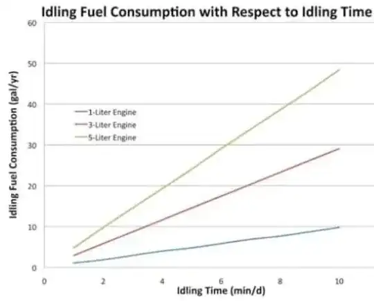

For fuel injected engines, this paper suggests for a 1.5 litre engine it takes 1.1ml to 1.2ml of fuel to start a car. In another study, the graph below (link) suggests the amount of fuel used when idling is, in relation to engine size, linear - the bigger the engine the more fuel.
So, when idling a 3 litre engine you will use twice as much fuel as a 1.5 litre engine (0.6 litres per hour) and I would expect this difference to be the same when starting a car because the amount of fuel used starting a car, like idling, is dependent on engine size.
