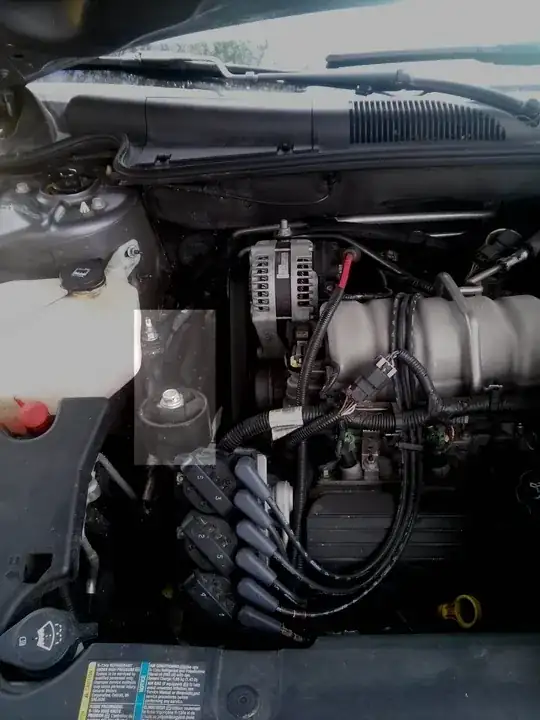

I don't understand the answer. I just did mine - looks like the highlighted dogbone in the picture above.
Use 18MM socket, preferable deep well.
The rearmost end has a stud and a nut, the front end has a long bolt.
Remove them both - and lift the torque strut off of the stud, and the whole thing easily lifts out.
Place the new one in position and replace the nut and the bolt.
Don't over torque the bolt or the rubber bushing will be distorted. You are done.
