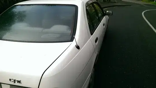

The car is a 1997 Nissan Pulsar (N15 chassis) (same as an Almera in the U.S.) as pictured below with the location of the power antenna.Location of the Antenna.
