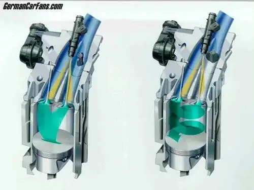

The Twinport Ecotech engine is the second generation of the GM Family 0 engine technology (also called Family Zero ... haha, could even be "Family Zed" in the right parts of the world, eh?). It works by having the ability to close off one of the two intake ports near the intake valve at low engine speeds, which speeds up the air entering the cylinder and causes a swirl of the air fuel mixture as it enters. This produces better low end torque. Coupled with advanced exhaust gas recirculation allows for better gas mileage without engine misfires (from the extra exhaust gas). As the engine speeds up, the secondary port is opened. Here is an image of how the air flows into the engine with (left) and without (right) the port open:
Since this should not affect high end horsepower output, I'd suggest the difference between the two engines is the compression ratio bump (10.1:1 vs 10.5:1 for the Twinport) and probably tuning. As a rule of thumb, every point of compression is worth approximately 3% change in horsepower, so that alone would not make up the 7% difference.
