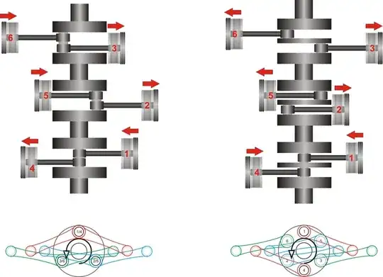

True boxers have each crankpin controlling only one piston/cylinder while the 180° engines, which superficially appear very similar, share crankpins. The 180° engine, which may be thought of as a type of V engine, is quite uncommon as it has all of the disadvantages of a flat engine, and few of the advantages.
You have to look closely at the image above but you can see that the pistons are not sharing crank pins. In the image below we can see a true 180 degree V6 (on the left with shared crank pins) compared to a boxer flat-6 (on the right with individual crank pins as in the Subaru).
"Moteurs à Plat - V à 180° vs. Boxer" by Frank Lente - http://de.wikipedia.org/wiki/Datei:Boxermotor.png. Licensed under CC BY-SA 3.0 via Wikimedia Commons.
As stated in the article, however, the 180 degree V4 is quite uncommon due to its technical limitations. Note those arrows in the left-hand diagram: instead of having opposing pistons box each other (somewhat cancelling vibration), they would be reinforcing each other. This would cause a truly distressing torque of the whole engine around the vertical axis, with the direction changing every half rotation of the crankshaft.
As the 180 degree V4 with shared crank pins is so uncommon, the flat-4 boxer effectively takes its place in terms of "what would you do if you need to increase the angle to 180 degrees?" Therefore, in the common usage we consider a 180 degree V4 and a flat-4 to be effectively the same thing.
