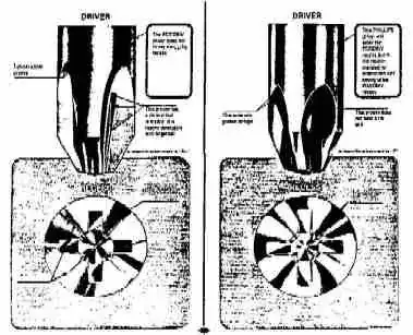

Here is a side-by-side comparison of the two driver types (Phillips left, Pozidriv right):
Phillips vs. Pozidriv

The Pozidriv screw is an advanced version of the Phillips screw but the key difference is that:
  • Phillips drivers have an intentional angle on the flanks and rounded corners so they will cam out of the slot before a power tool will twist off the screw head. The Pozidriv screws and drivers have straight sided flanks.
  • Each of the arms of the cross are parallel-sided on the Pozidriv, but they are tapered off with the Phillips. (refer the below image, look at the 45° notch between the arms)
    Ignore the spelling mistake on Pozidriv
This design is intended to decrease the likelihood that the Pozidriv screwdriver will cam out, providing a greater driving surface, and decrease wear
As you state , Phillips screwdrivers will fit in and turn Pozidriv screws, but will cam out if enough torque is applied, and can damage the screw head.
BUT.
The marker lines on a Pozidriv screwdriver will not fit a Phillips screw correctly, and are likely to tear out or warp the screw head. Slippage is also possible, if the screw is relativity new and not subjected to corrosion.
Meaning, if you use a Phillips on a Pozidriv you have greater chances of slippage.
But if you use a Pozidriv on a Phillips it will shred the screw head and slippage is always better than destroying the screw thus, so you can at least try the former if you have no proper tool kit.
The above is the only main disadvantage of the Pozidriv head , its very similar to look as the Phillips and unaware users end up with damaged/warped screw head.
