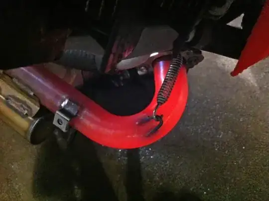

Yamaha dirt bike with exhaust glowing red.
