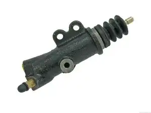

  1. Pump the clutch to build up pressure (pumping the clutch is referring to depressing it with your foot repeatedly to build up pressure in the hydraulic system, keep clutch depressed)
  2. Open the nipple/valve on the slave cylinder
  3. Allow fluid/air to escape from the nipple/valve
  4. Close nipple/valve on the slave cylinder (see image below for an example of a slave cylinder, the 'nipple' that is being referred to is brass colored)

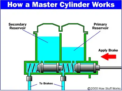

Bonus Answer
Here is an image of a cutaway master cylinder.
As you can see, it acts as a one way valve after the plunger passes the gravity fed fluid delivery in the bottom of the reservoir. Once that point is passed it hydraulically compressing the fluid to displace a piston in either brake caliper or a clutch which is actually actuating whatever component the engineers want it to. Upon retraction of the plungers the piston is able to pull back and any fluid that needs to be displaced back into the reservoir can have a path to it.
