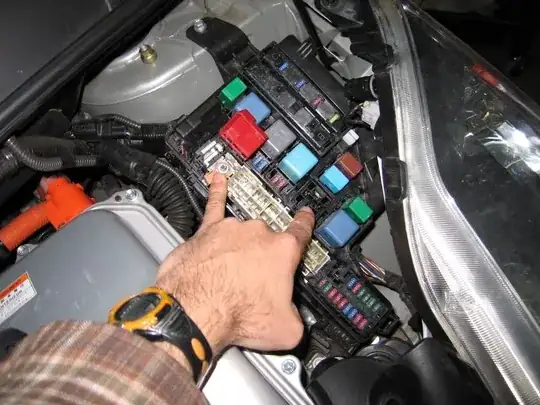

You have a couple of choices to move the Prius out of the garage. You cannot shift it into neutral without the 12v battery. What you can do, however is jump the vehicle from the front end. Here is a picture I acquired from this website which shows where to put your jumper lead at (the pinkie finger):
found on Priuschat.com
You can place the black (negative) lead on the gold colored stud/nut at the 11 o'clock position. This should get you enough juice into the system to put the car into neutral (probably not enough to start it). Once you have the car in neutral, you can remove the relay which is where the pointer finger is pointing to (already removed in the picture). Then once you remove the power, the car will stay in neutral and you can move it.

The easiest way to jump a Prius is from the front junction box as shown above (and detailed in your manual). Instead of a 20' jumper cable, which would be quite heavy, I would suggest buying or borrowing a battery-based jump starter device such as this. The last time I called a towing service to jump my Prius, they brought a battery-based device, which made the process much easier.
