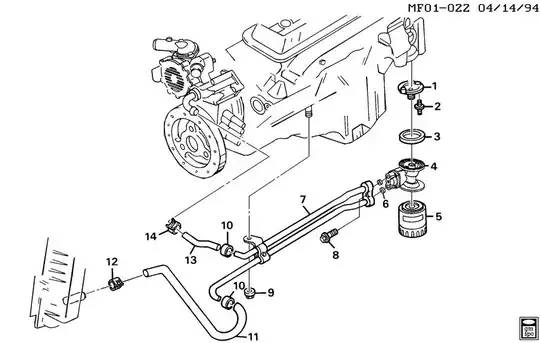

Your problem is probably with the oil cooler. The LT1 can have an oil cooler which pushes coolant through a housing at the oil filter. It cools the oil as it enters and exits the oil filter. Here is a diagram of the system:
You'd be looking at #4 where the heat exchange occurs. If this housing were to crack or have an issue, you'd be pumping oil into the coolant system due to oil pressure usually being much higher (should be over 2x the pressure in the system) than what the coolant sits at fully warm.
With this being the issue, it's also the reason your vehicle continues to run well.
