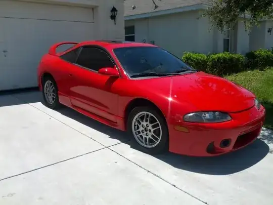

I have a '99 Mitsubishi Eclipse GS that has a terrible vibration problem that occurs at all speeds, with it being very bad on the highway. During turns, it gets worse then better, as if both front wheels are bent and they go in and out of phase with each other. Everything seems to be okay suspension/hub wise.. but I tried running the car in gear on jackstands and the front wheels (driven wheels) are not round!
Could it be bent wheels?
Should I bite the bullet and buy new ones or find a company that will repair them? They're the OZ Racing wheels that I suppose were an option on the car back in '99, as seen on this car (not mine):
