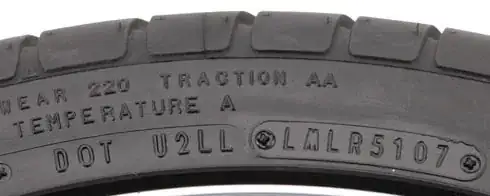

Most legislations require tire manufacturers to list the week and year of manufacture as a 4-digit code on the sidewall.
Tire Rack Pic
In the example picture, the last four digits of the tire identification number (5107) refer to the week and year of manufacture (WWYY format).
This means that the tire in the image was manufactured in Week 51 of 2007 (mid-December).
