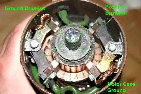

If your starter motor is working 8 times out of 10 then you probably need to replace it. It very likely has developed a dead spot on the armature. If the armature is positioned so that the brushes land on a dead spot, it won't start.
Brushes are the electrical connection between the power source and the moving armature. The picture below shows how these brushes rub against the armature. All of the rubbing eventually causes enough wear that the connection becomes unreliable. (Picture from PontiacBonnevilleClub.com Illustrated Starter Tech 101.)
Sometimes this can be temporarily overcome by tapping on the starter motor case so that the electrical connection is good enough to move the armature past the dead spot so it will start when you try it.
In your 8 out of 10 times, the starter motor isn't on a dead spot, so it seems to work fine. You will eventually find out that tapping doesn't work and you will need a tow to the mechanic. It's better to fix it before that happens.
